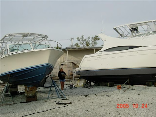

My original thoughts on the cradle were from my experience with Hurricane Wilma in photos below. Every boat at Seminole boat yard was down and off their jack stands except for my 26 Bertram in the photo, very lucky. After that experience I keep trying to think of a way to keep the boat from being on it's side like the others shown. The yard I'm currenty in has an asphalt drive area. I don't think they would appreciate me screwing tie downs into it. The cradle does pose an issue for storage when I'm not in the yard, and I would have to build it to accomodate the fork lift. Yes it's starting to sound complex.
My other alternative is to buy a trailer and put the boat on my spare lot next to our house. Not sure if anyone on the island has a truck strong enough to pull it and launch it, plus we don't have a decent ramp on the island yet. That's another project I'm working on but it's creeping very slow to get funds or any enthusiasm.
I'll see if I can get tie downs in the yard somehow to the asphalt surface.

2005 Hurricane Wilma: Seminole Boat Yard North Palm Beach, FL

I don't see a stand chain in any of the pictures. I know most yards think that only blow boats need chaining. I wouldn't put mine on stands without chains that are tight enough to hold them together. Chains don't guarantee anything, but they are cheap insurance.

Mikey, from what I recall there were no chains at Seminole. I've hear everyone say put chains on them. Does anyone have a picture or an explanation of how to chain the jack stands in place/togther? I suppose you could chain all four in a box configuration. Or, here's an idea. If I owned my own jack stands and knew exactly the spacing placement, I could cut some galvanized steel tubing and connect the jack stands with brackets, thereby making my own cradle without the hassle of building a wood one, and it's adjustable, and storage is not an issue. Anyone like that idea? Or find flaws in it?

The safety chain runs from one of the stand pads under the keel and to the opposing stand pad. On commercially made jack stands there is a key hole in the angle iron cross brace designed to fit 3/16" galvanized chain.
Sometimes you can find used stands from a boat yard, but probably you'll have to buy new. Brownell makes the best stands: http://www.brownelltrailers.com/rok-boat-stands/
