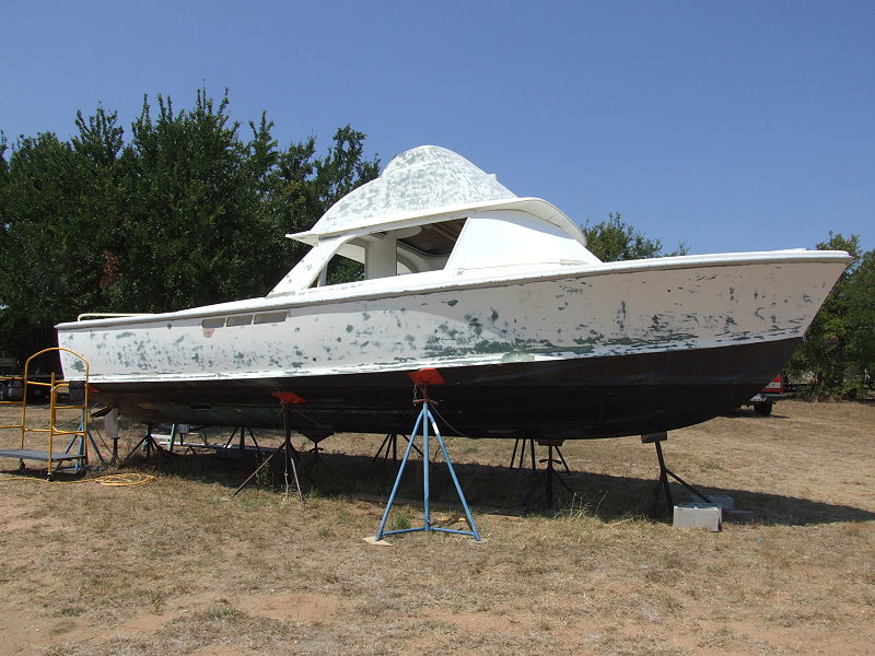

CaptPatrick wrote:
i was fortunate enough to get 4 decent size stands with the boat.

Re: Jack Stands Layout Drawing request
CaptPatrick wrote:
i was fortunate enough to get 4 stands with the boat.
