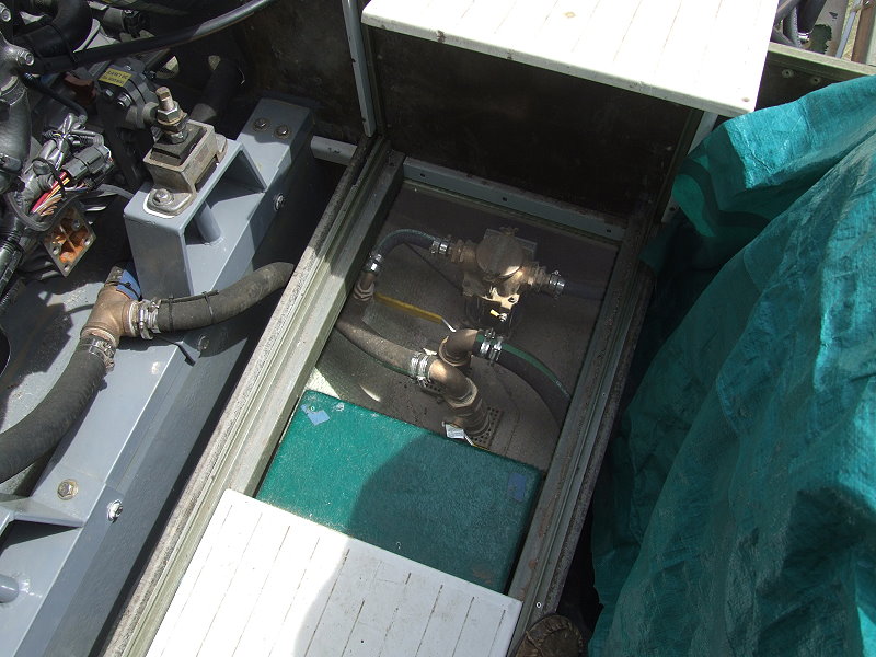

I had thought about installing a dam between the engine boxes at the edge of the cockpit by making a slide in "hatch board" like sailboats use in their companion way. But now with a family I don't go out in the big water so it doesn't matter!!

Keith, Deck on my 31 has a 6" step up at the engine boxes, that should keep some of a monster wave from making a b line into the cabin, if the pit gets flooded I can put her in gear and open the tuna gate and dump a few thousand gallons pretty quick. Hope I never have to find out..BH

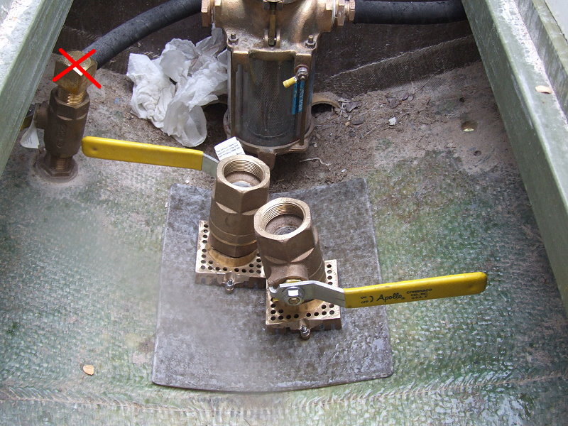

i had crash valves but never had to use em. i did have over a foot of water in the bilge when i blew a raw water hose. two 2500 GPH pumps emptied her pretty fast. another time a neighbor's bertram was pretty flooded at the dock after a hurricane. (i get there is a huge difference between at the dock and 50 out in 10+). i was surprised how much water she would hold and not sink. i pumped it with a sump pump.

bruce....i gave exactly that a lot of thought when i built my crash valve system. so i made them as easy to use as possible. to me the deciding factor was can you stop the water from coming in? if you can its the big bilge pumps. if you can't...like a hole or broken off running gear i figured i could match engine revs to water flow.(using one engine to pump) glad i never got to find out. i do know a guy out alone at night who hit a log and holed the bottom. he detached a raw water intake hose, put it in the bilge, and ran home running his boat up on the launching ramp. not pretty but he saved the boat.
What IS a "crash valve system"? I'm possibly familiar with the concept but not the term.
I would have run up a beach (nice soft sand) instead (assuming that was an option). Having said that, in naval practice having a T valve (connected to a hose and strainer in the bilge) on the raw water intake hose to facilitate emergency bilge pumping is SOP. I personally have modified every boat I have ever had to that configuration. Don't forget to make sure that the valve can't be accidentally turned! A simple pin based solution works fine in my experience.
Re: Your Opinions please
Yup, that's a crash valve...
Keith Poe
Posts: 491

Navatech
Post by Navatech »
One more project to add to the list
Do NOT forget, "crash valves" are an emergency option! You should have at least two bilge pumps (located as low as you can). Preferably connected to automated switches (floats). The pump connected to the lower float should be a "regular sized" pump that's sized to handle "regular" water ingress. The pump connected to the upper float should be an oversized pump that's sized to handle "flooding" water ingress.
Due to my naval background I prefer to have an additional gas or diesel (depending on the boat's fuel) powered portable self priming pump on board. I usually store this pump in a water tight box up front (next to the dingy and raft). This can be used for emergency pumping on your (or someone else's) boat by dropping the pickup pipe (with strainer) into your (their's) bilge. The discharge goes overboard. It can also be used as a fire fighting pump to fight fire on your (or someone else's) boat by dropping the pickup pipe (with strainer) into the sea. Of course, for the latter you need a suitable discharge hose. I use a short (7 yard) 1.5" rubberized canvas firefighting hose with suitable nozzle.
I prefer to get the Selwood PD75 or PD100 Spate unit for this application. Hand crank started and practically foolproof.

I have three way valves on both engines and the gen set.
I also keep 25' of 1.5" hose with a barb X barb fitting already in one end in case I need to vacuum water from somewhere other than mid ship, or my own ship.
The valves make winterization a breeze.

As I said, I store mine (wheels removed in favor of a skid like replacement) in a watertight box on the front.
The set up time rather then just having a handle to move on the crash valves
First, it's not one or the other. The portable pump is an addition. As for set up, there is none. I remove the cover, connect the pickup hose and drop it into the boat and down into the bilge through the skylight/hatch. Then I start the engine.
in case of fire how do you get your fuel from the boats tank to this thing?
It has its own fuel tank. Enough for several hours of operation. I match the fuels for replenishment purposes.

PeterPalmieri wrote:I did replace my seacocks for the engine SW intake but mine are in a funny spot just forward and inside the shafts, up against the stringers and couldn't make a 3 way fitting work.
You can put the three way valve anywhere in line. Cut your raw water intake hose in a convenient spot and insert the valve. You need:
A hack saw to cut the raw water hose.
A 1.5" three way valve.
Three 1.5" thread to hose fittings
Six hose clamps.
A length of hose for the crash opening with a plastic strainer on the end.
