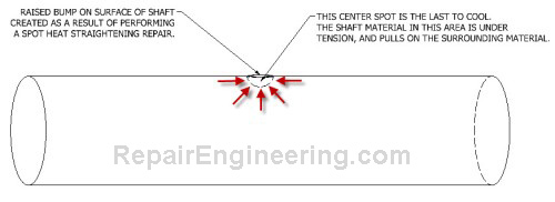

Put the indicator on top of the shaft in the area between the rollers or vee blocks. Rotate the shaft and determine the "High Spot"......that is where you apply the heat.
When you are working on the outside of the rollers you will apply the heat on the low spot.
There is a technique in applying the heat. This proceedure requires very little heat to move the shaft but the heat needs to be intense and accruately placed on the shaft
If you leave the indicator in place and heat the shaft near the indicator...you will first see the indicator continue to rise (get higher) but when the shaft cools, the indicator will fall below it starting point.
Carl, if you very accruately control the amout of heat and the posistion of the heat you can actually move the shaft .001" and feel comfortable that you can control shaft movement.
But the trick is to adjust the torch to burn with a neutral flame, then put the torch so close to the shaft that the 4 (or 6) small points of blue flame actually touch the shaft......for only one second or less.
Some shafts are bent so that they sort of resemble a "Crankshaft"......these guys are buggerbears to straighten.....but it can be done.

How does the spot heat shaft straightening process work, in principle?
Experienced welders are familiar with metal distortion, known as "drawing" or "heat affected zone", that occurs during the welding process. Spot heat shaft straightening uses the same principle. The mechanics of the process are as follows:
1.A small area is heated quickly so that the material in the localized area is in a softened, semi-plastic state while the surrounding material remains relatively cool and solid.
2.The spot-heated material expands as it is heated. Because the locally heated area is surrounded by solid (cooler) shaft material, the thermal expansion causes growth in the only unrestrained space available... toward the surface of the shaft. This expansion creates the raised bump on the surface of the shaft that is characteristic of the process.
3.As the shaft is cooled, it would be natural to assume that the material in the raised bump would return to its original state prior to heating. In actuality, the exposed surface of the bump cools the most quickly - and becomes solidified in the raised condition.
4.The very center of the heated spot is the last to cool and, as it cools, the material contracts. At this stage of the process, the center spot is surrounded on all sides by material that is in a cooler, solidified condition.
5.The contraction of the center creates a tensile stress at that location that is very close to the yield point of the material. The localized tensile stress exerts a force that pulls on the surrounding material and causes the shaft to deflect.
In Figure 5, the red lines indicate the shaft forces generated as a result of the localized area of tension. When performed properly, in the correct location, the tension forces can pull the shaft toward straightness.
Figure 5. Spot heated shaft.
