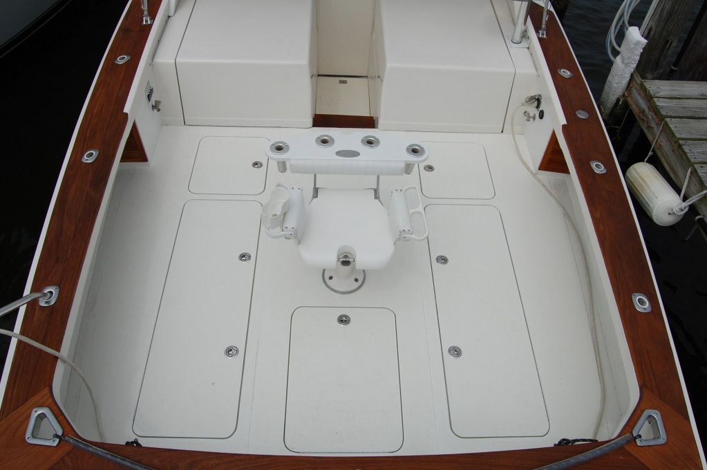

battery placement statement incorrect will not be tight and not be wet -------i through we went over this battery placement a long time ago. mine are in place 15 years and still perfect without a hint of corrosion. weight must be down the centerline of the keel with no exceptions.i have my original batteries from 2005 so they are in the boat 16 years and still perfect and of course AGM batteries do not breath. BTW my front compartment is sealed at the main bulkhead and if the water goes over the battery boxes and four bilge pumps failed and at high throttle with crash valves also failed (i don't see how that is possible ) it means i am going into the life raft . a floating piling wet right thru the hull below the water line or i hit a mine. either way mathematically calculating the salt water level even with top of the battery boxes and level with cabin floor she going under.that you can take to the bank-----------abandon ship

photo is without battery box covers. i know Carl has his thinking cap on -----------------your are absolutely correct and a smart man the reality of the salt water coming over the level of the cabin floor (the height of the top of battery box) is rather mute because that would also indicate the main battery conection to the starter motor is 6" under salt water!!!!!!! unless you have 3126 cats.

…and of course AGM batteries do not breath.
True, they do not breathe, but they are vented with a one way valve to prevent bursting if overcharged. They are still a lead acid battery that creates hydrogen gas.

never saw that vent in a fiberglass mat battery.made by Odyssey. they appears to be sealed. i had one upside down in a box (not knowing) for a week with no leakage.so they must be a one way valve . venting is not even a through in the companion way of a 31 Bertram . every damm leaf or debris ends up going thru those seams around the deck insert.

the step into the companion way is on a piano hinge lift step and engine thru hulls, valves and crash valves are easily accesed to run fresh water flush thru engines or salt away flush and anti- freeze at end of the season

The step in my companion isn’t stock. I have a flat deck from the engine bulkhead to the cabin bulkhead. I have a step floating above that which tied into the engine side panels. Makes my layout a bit different and an even better place to trap leaves.
