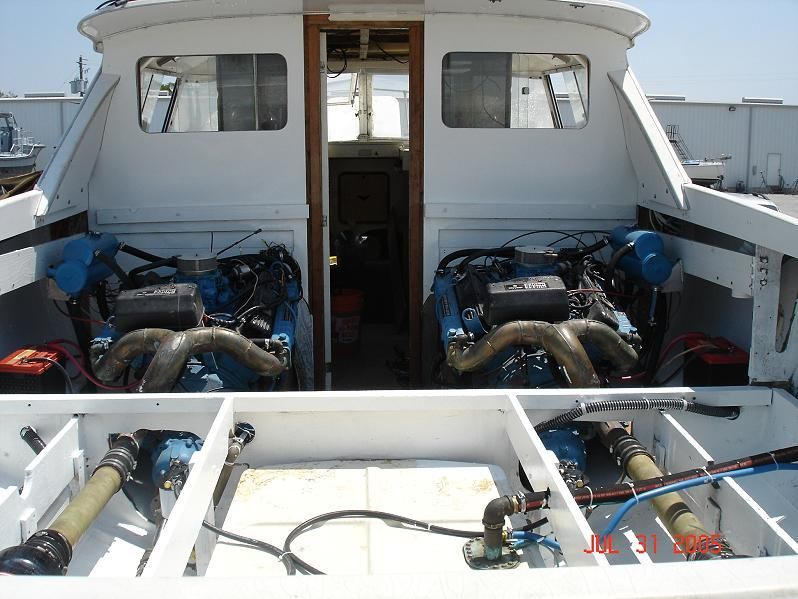

Not my boat, but these are the ones.
Or look at how they do diesel risers and elbows...all about the same idea.

coolair wrote:so whats wrong with a pair of those in a Bertram????
![Very Happy :-D](./images/smilies/icon_biggrin.gif)
Nothing....but
You would have to modify the inboard headers to go up and over the motor while lengthening the outboard headers to keep same length for each side.
Doable.
Of course it would all have to be 316L for the sidepipes so they do not corrode, and either do a tandam over under OR larger pipes...
An up side to having sidepipes on a boat when fishing...you can TAG the fish with a custom Brand (AKA- Branding Iron). Just bring the fish along side and give a touch.
Ask my wife to show you the nice Tag on her leg from mine. Interesting that I decided to go with the old Stock fiberglass covers so as not to brand her when she got out of the car. But she was so anxious to go for a ride I didn't have time to put them on. I can't tell you how many times I told her to be careful, pipes are hot, be careful, pipes are hot...She wasn't careful...and the pipes were hot!
Huh, here we go...another up side!!
Seared Fresh Tuna, right out of the water!
