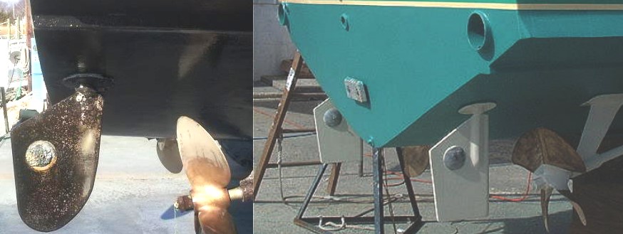

Hello All,
I have posted several times in the past about my steering problems and there was a post about a year ago where others indicated that they had similar type issues. There was discussion in that thread about rudder stall or cavitation as a possible cause. I did some internet research and found that the problem occurs when the rudder extends past the transom as is the case with my boat. The rudder stall certainly resonated with my problems. Also, I believe JP had a post where someone addressed the problem, albeit on a smaller Bertram, by adding some fixed tabs (inexpensive way to extend transom).
I figured what the heck it is fairly cheap to build some tabs, so that is what I did. A 12” x 12” sheet of 3/8 fiberglass, 4”x4” aluminum angle and some epoxy and the job was done. The plane of the fiberglass tab follows that of the bottom of the boat. Much easier than relocating the rudder posts! (Huge understatement).
Anyway, I dropped the boat in over the weekend and I am elated to report that the tabs work like a charm! NO MORE STEERING ISSUES. Many thanks to those that shared in the discussions in the past threads. Some pics follow:

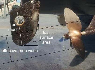

Tony,
That rudder style was OEM from Bertram for a few boats. I refer to them as inverted shark fins... They actually have as much blade surface as do mine, but the difference is in the swept back design. It misses a large vital part of the blade that should be interacting with the prop wash and far too much trailing edge which drags and contributes to the rudder stalling...
But the reason for developing my design was primarily for those ocassions that either you lose an engine or want to slow troll on a single engine, and still want to steer a straight line or even turn against the live engine.

Nav,
No, it's not just you... Here's a comparrison between Jim Bailey's and Vince's. Vince's rudder ports seem to be about 2" - 3" further aft. Maybe more, it's hard to gage exact measurement from an image that not in absolute scale.

Guys,
I agree with all the observations regarding the rudders not being deep enough and looking awfully close to the transom. It appears to me that is how the boat was originally set up. I do not see any repairs in the hull that would suggest that they were moved. Also, the tabs did not do anything to the performance of the boat when she is up on a plane.
