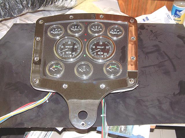

I have a plexi panel with rounded over edges on a Scarab Sport that look nice and is easy to make. You can use smoked plexi or paint the back of plexi for different effects.
