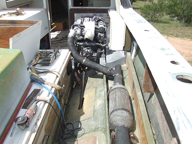

The engines are the 4 banger Yanmars so exhaust system is 4", so didn't need to raise the deck, (muffler diameter is 9.06"). The mufflers ride in sealed mahogany cradles and each cradle has a strip of 1/4" neoprene rubber under the exhaust hose, with the exhaust strapped down in the cradles.

rick this is the exhaust on port side. notice by going up and over from turbo the height of exhaust is even with gunwale or coaming boards, port is the same height as the exhaust goes across it comes to 4' by 6' adapter to 6' sprinkler head where the raw water from heat exchanger comes in in a perfect circle within ss sprinkler head .cool to touch 360 degrees. port has same set up next exhaust and water go thru blue silicon hose and into 6" mini max exhaust were a inverted (one way) cone helps the flow by putting exhaust to inside and water to outside of 6" rubber exhaust hose . i use coast guard exhaust hose to further quiet exhaust all the way to bronze outlet. back up wot. if you could!!!! water surge cannot get past cone then 90 degrees uphill then thru sprinkler head not happening!!!!.
