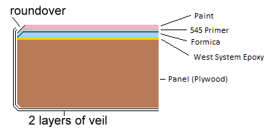

If you are referring to the cockpit side panels here is how I worked things out with Capt. Patrick's help:
CaptPatrick wrote:- Laminate Formica on to boards with West System (with some cabosil?).
- Trim up edges with laminate trimmer and seal end-grain of the boards with thickened epoxy.
Use enough Cabosil to make a mix the consistancy of mayonaise...
Use a round over bit to avoid 90 deg corners. Use a couple of layers of veil. Epoxy by itseft will shrink and crack down the road...

I redid mine 5 years ago. For my cover boards, I just used high end marine ply (Okoume) from a local East-Central Florida company. This type of ply is used for making wooden boats that are stained/varnished to show the wood grain. So the finish is very smooth, but not quite Formica.
http://plywood.boatbuildercentral.com/p ... ume_BS1088
I used 9mm and doubled up the thickness around all of the boarders and cut-outs for added strength. The doubled up thickness was epoxied using West System with Cabosil. All fixture holes and attachment points were pre-drilled to ensure all edges would be sealed in the next step. Then everything was sanded, corners rounded over and 3 coats of West epoxy to seal in the wood.
I used Interlux Brightside single-part polyurethane and followed the roll-and-tip method. 3 coats of primer and 3 coats of the paint. It would take a well trained eye in a very low-profile light to find a brush stroke in the finish.
